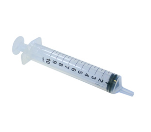

Post by Tex » Fri Jun 22, 2012 3:39 pm
This can be your friend......
Work from the back upwards. Something like this?
http://www.youtube.com/watch?v=lBk00597EyE

Post by Cromag » Fri Jun 22, 2012 5:39 pm
Listen to Tex it will make it easier...and eig a honda they always take a while to build up pressure and remove air.
