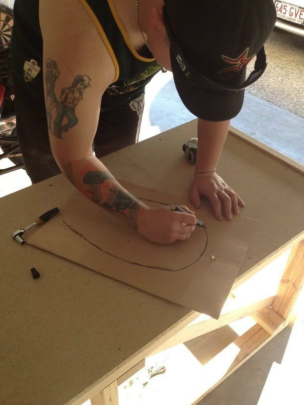

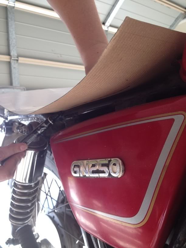

I just got a bit of soft cardboard, placed it on the frame and traced along the frame. I then joined both sides with the shape of the back I wanted. Will put up a pics of the process if you want.

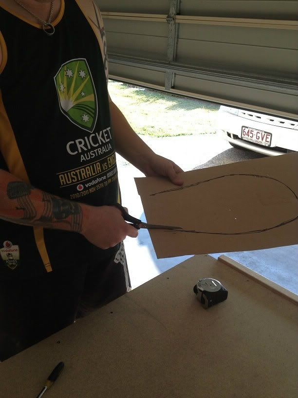

Just a quick "How to bobber seat"
Piece of crap cardboard
Place on the frame of your project
Trace the frame from underneath
Tidy up the sides and draw the end shape you desire (For shaping etc)

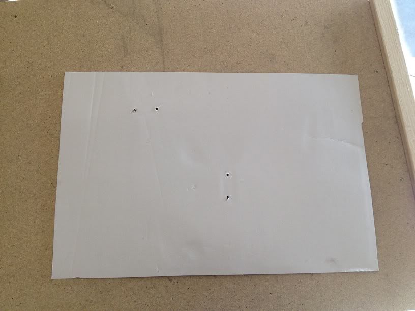

Cut the template out and trace around it on the aluminium/ steel sheet your using.
Cut along the line with a thin cutting wheel, and do what is necessary for your mounting point.
Can do any shape you want but this is what I needed to do, to get the shape I wanted. Have fun :D

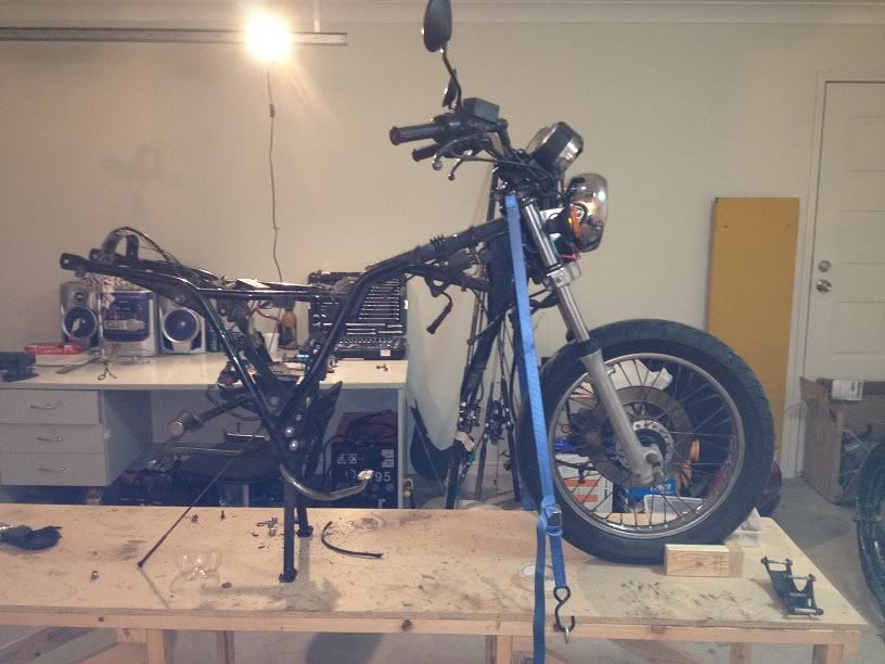

Stripped her down today, and i am now shitting myself haha
Scary looking, not sure what the hell I'm doing

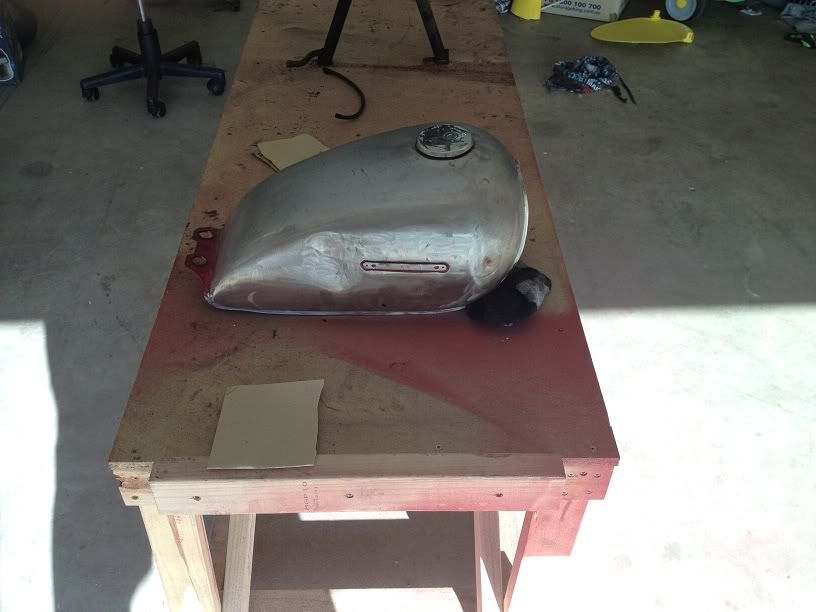

No dough at the moment, so onto cleaning the tins. Tank all stripped and ready for some filler, and then quote for stripping the chrome

Post by xsive » Sun Aug 19, 2012 4:47 pm
Yeah it looks daunting .whats your plan now you have it this far? tell us what you want to do and ask questions .most all will have been where your at right now .is it just a freshen up and paint ? want to change struff ? there is easy ways and hard ways to do it.ask if ya not sure before you go into the land of no return and get stuck there is lots of answers between us all
