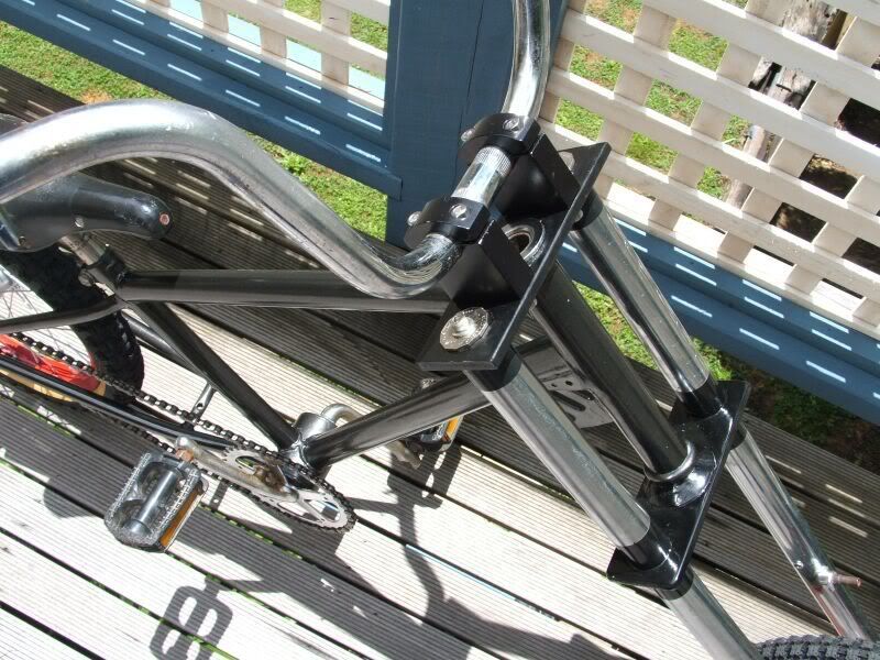

Dave, go grab yourself some 6ml plate, 40ml tubing, 40ml holesaw and two large bolts with their matching nuts.
Unless you're up for joining an axle, don't make the forks too wide apart, keep em within range so you can use the original one or one from another donor.
A nice FLAT & solid workbench is invaluable, very important to keep everything ridgey didge when you're tacking it all together, it's backbreaking stuff working on the ground.
Couple of beers later you'll have a front end looking something like these two here, which were my first two attempts.
I don't think the rake/trail dillemmas will bother you on a trike seing it doesn't lean, so no probs there either. If you don't want to make the risers, ones from those little pit bikes, or pocket bikes work pretty well ( like on the pic above )
Good luck with it all. 8)
