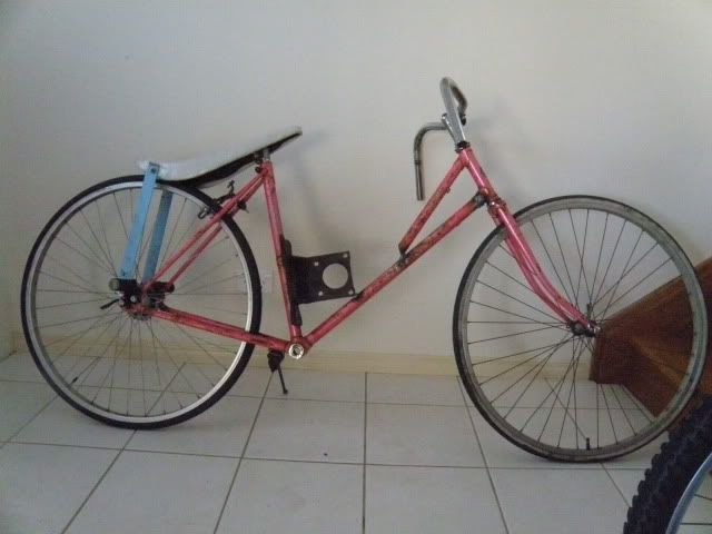

Post by psychomatt » Thu Nov 26, 2009 7:49 pm
the rake after all advice

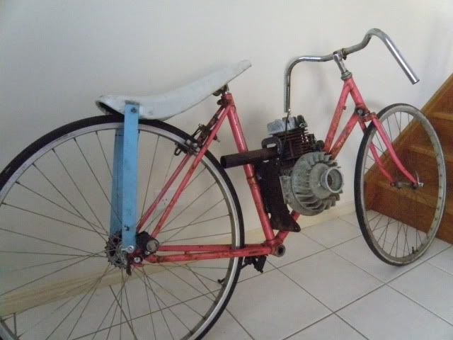

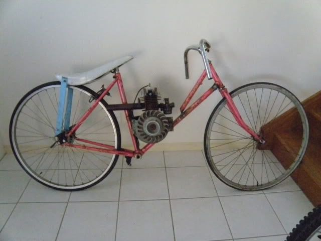

Post by psychomatt » Thu Nov 26, 2009 8:02 pm
motor welded in and im thinking i will get a 50cc tranny and smash it to fit!
Post by Cromag » Thu Nov 26, 2009 8:28 pm
I dont know what a 50cc tranny is (sounds a bit 'hows ya father' to me) but why not go a trad friction device, you apply leverage to said device it pulls a belt or similiar tight and your motive force begins to spin....kind of a simple clutch.
....stretch the back a bit.

Post by Happosai » Fri Nov 27, 2009 8:07 pm
I would suggest a bar between the top of the seat post to the steering head, otherwise it might brake in half :D definitely a death machine
Post by sks » Fri Nov 27, 2009 11:56 pm
how about butting the crank back in and running a belt drive to the oppsitate side of the chain and use the cromag system for a clutch.

Post by Ol Fart » Sat Nov 28, 2009 5:52 pm
And the bars need to be shortened and swapped from left to right.
