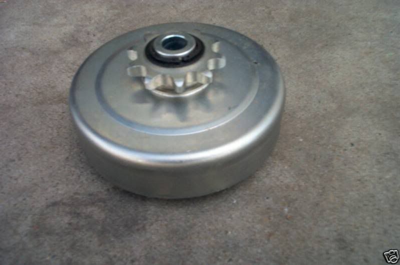

could i mount something like this to it?
http://cgi.ebay.com.au/Clutch-Pull-star ... 3ca7c04d4c
Post by Bacca » Wed Mar 10, 2010 11:33 pm
Like this, must be able to find 1 cheaper
http://cgi.ebay.com.au/GO-KART-MINI-BIK ... 414d556b4a
$199
http://www.gaspares.com.au/catalogue/mo ... 34-245.pdf
No price on this 1
Mini Bike Sprocket & Centrigugal Clutch Assembly
3/4” Bore, 10 Tooth.
Use # 40 or 41 (1/2”) Chain
3/16” Keyway & Allen Set Screws included.
6 metal shoes engage at 2,000 RPM
Stainless steel garter spring
Works clockwise or counter-clockwise
Oilite bearings for long life.
Standard Pack 1
