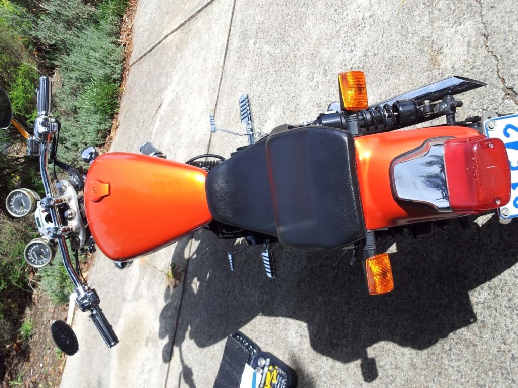

Now if I can just find the rest of the parts I need to put it together (canna find the choke ANYWHERE), and can work out how to split the right control to change back to the twin cable throttle (anyone know the trick for that? The Viagra has the standard aftermarket Harley controls, Image I know that I couldn't sort it out when I tried to replace the throttle cable about 9-10 months ago), I should be able to have some fun.

Thanks, but I have to change it from a single cable throttle (early '80's Hitachi) to dual cable (Mikuni HSR-42), I have new twin cable grips/throttle and a new set of Harley cables which will be long enough, my problem last time when I was trying to replace the bodgy throttle cable was that I couldn't work out the trick to separate the halves of the right hand control once I'd removed the allen bolts, while the auto electrician was fixing the screwed up electrics he got a guy over from the bike shop to pull it apart, but I never worked out how to do it myself.

from memory i think there is two allen bolts under side and one on the top side

Thanks Steve, looks like I have more searching to do, I've never been able to find more than one allen bolt on the underside, aside from the 2 bolts for the brake lever collar :o(

Yep, that was it, another allen bolt hidden up under the brake lever collar, thanks Steve.
