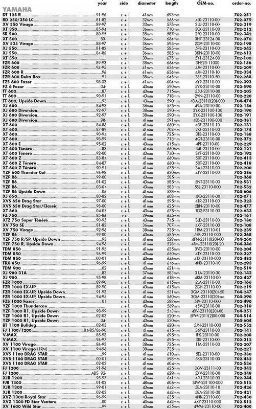

have been looking thru this information , have you got a list that covers an xvs1100 classic, 2005 model , i am looking into changing standard forks to longer ones

Reaper just grab a Vernier and measure the forks on your XVS then it should just be a matter of comparing that to the list.
By the way the list is very handy Bacca, Listings like that for every make would make it soooo easy to source different fork tubes.

smack me on the head hadn't thought about that ,as i have little or no mechanical experience was hopeing to find the correct size written somewhere ( have been searching the net ) so that i dont make a mistake and fit the wrong size effecting the trail, as i am not raking the neck ( at this time ) :twisted:

Without a neck rake, 4" -6" is about as long as you want to go. It will not increase the trail much, but will improve stability although it does also raise your centre of gravity a bit. You can counter that by dropping the rear end a little through shortening rear shockers or lengthening swing arm a few inches.
Don't use raked triple trees. There's more info about this in other places.
Modern bikes can all do with extra trail... if you rake the steering head, 40 degrees is a good compromise between stability and heaviness of the front end.
If you don't want to modify your frame, buy a second frame and have that raked. You can then always return your bike to stock to sell it.

looking at lowering rear 1.5 inches , would xt 600 fork tubes work , putting in progressive springs on front so spacers will have to be used to make up difference .

I have just had fitted 4'' xtensions on my 1100 vstar. I used tubes from a xt 600 yammy. they are 41mm x 710mm. I used 8'' spacers, a heavier oil, xtended brakelines by 4''. Tubes in perfect order from bike wreckers for $120.00. Bisho

Found a full chart of all japans makes here is the link for the PDF http://www.ohiocaferacers.com/OCRTubeSizes.pdf
