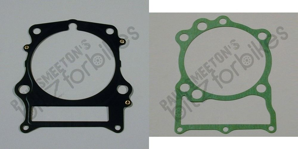

The XV engine origins were basically a pair of XT500 barrels and heads shoehorned into a V twin case, so MY crazy idea is that a pair of XT600 barrels and heads would make for an awesome engine if they could be mated to an early (81 or 82) TR1 case, the bore's the same, and the cylinder base gaskets aren't THAT different, so I'm thinking that a decent machine shop may be able to move the bolt holes that don't line up?
Image.
The XVS1100 crank is a straight swap into the XV cases, but the stroke's too short for the XT600 (75 against 84), on the other hand the XVS1300 crank is 83mm stroke, which could possibly be close enough to work if it'd go in. Ignition would be a challenge, but you can get adjustable digital units for the XVS1100, so one of them may be able to be made to work. High compression pistons, uprated cams and a bit of head work would be an obvious choice, exhaust would obviously be a one off (XT600s are 4 port, 4 valve heads), but intakes mightn't be that difficult, the factory Grizzly 600 2 into 1 manifold bolt on, so a pair of them could be mated to a pair of Khein or Mikuni downdraft carbs via 90 deg elbows. Theoretically, if it could be made to work, I think an uprated 8 valve, 8 port XTV 1200 V twin could put out twice what the native XV1000 did. (If I found a talented enough shop, it may even be possible to get the XT kickstart and decompression mechanism to fit and work as well)
