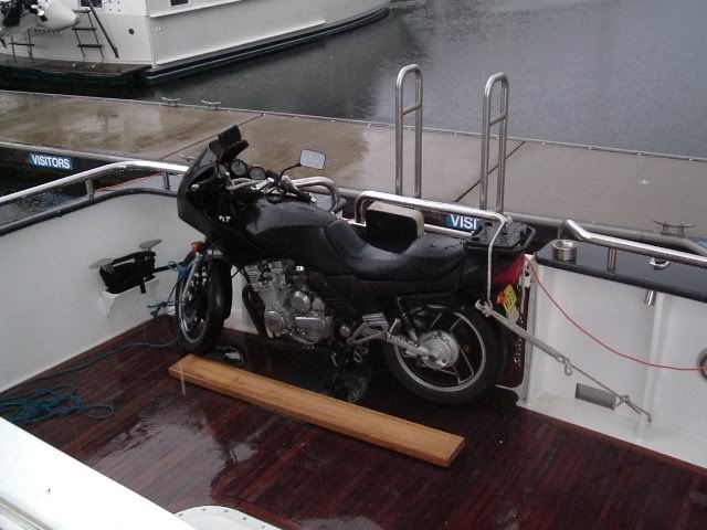

Had some interesting trips with it , even took it to sea.

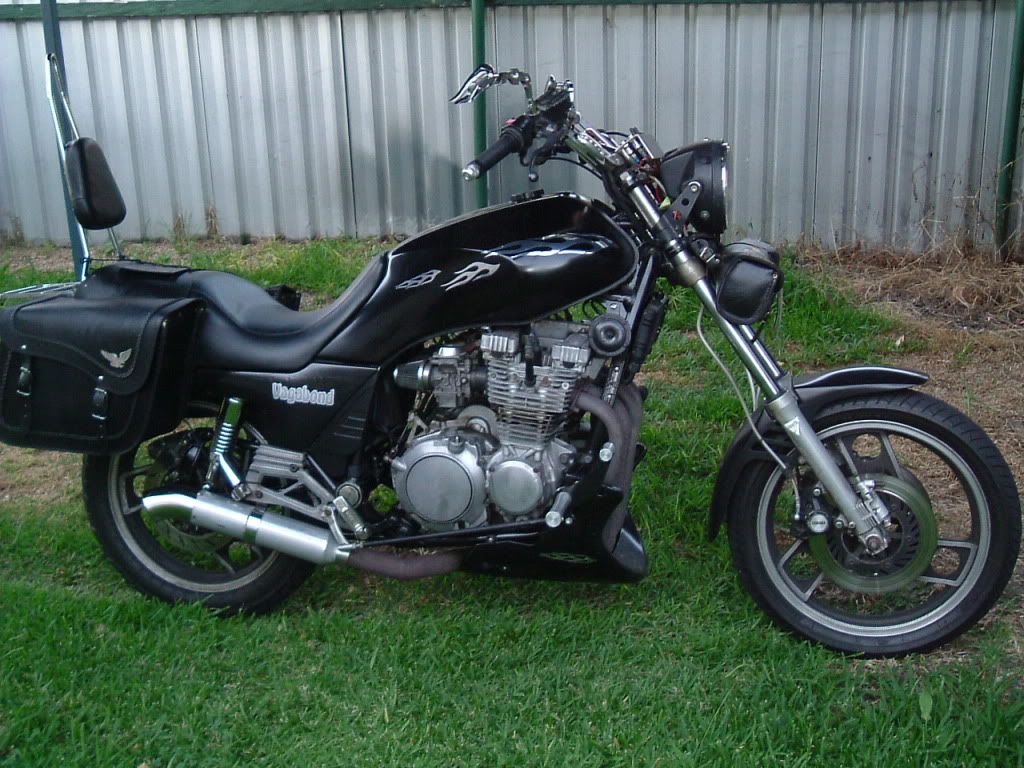

As it is progressing

seat
Post by ol_750 » Wed Nov 17, 2010 6:07 pm
Just did my seat but I think the flame on the seat ended up to much "in your face" might have to redo it & make the flame the same size as the one on the tank...
Sissy bar pad will be Crock skin too
Post by KeithinSB » Thu Nov 18, 2010 12:25 am
I think I like the flame on the seat....
Did you make the seat cover?
seat
Post by ol_750 » Thu Nov 18, 2010 6:39 am
KeithinSB wrote:I think I like the flame on the seat....
Hi Keith , yes I did the seat myself. When I was making it the flame didnt look to big , but when I put it on the bike it seems to hit you in the face. Its silver same as the flames on the rest of the bike .
