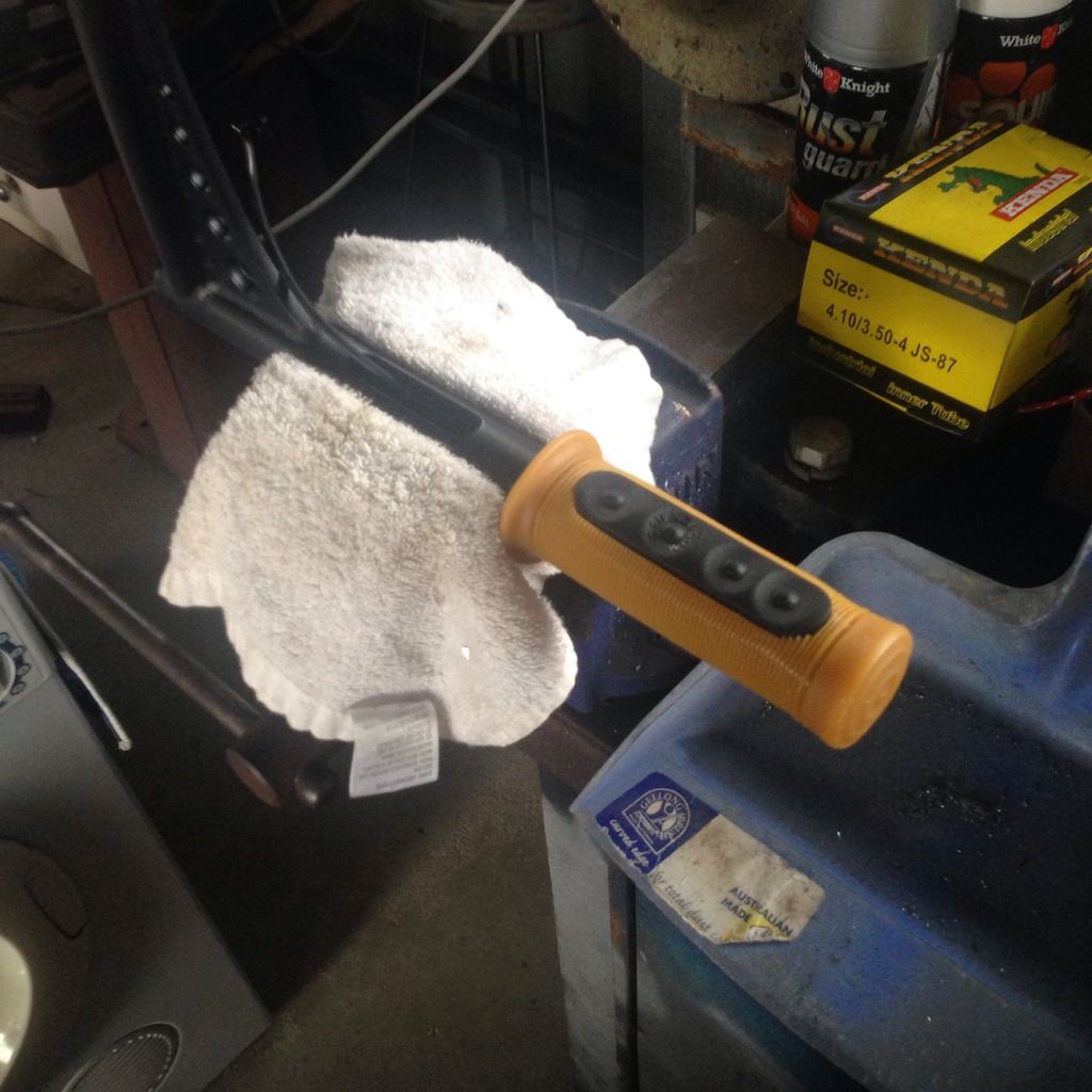

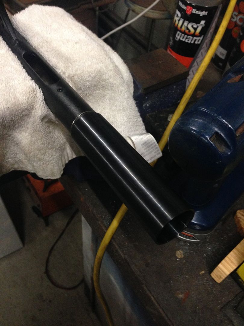

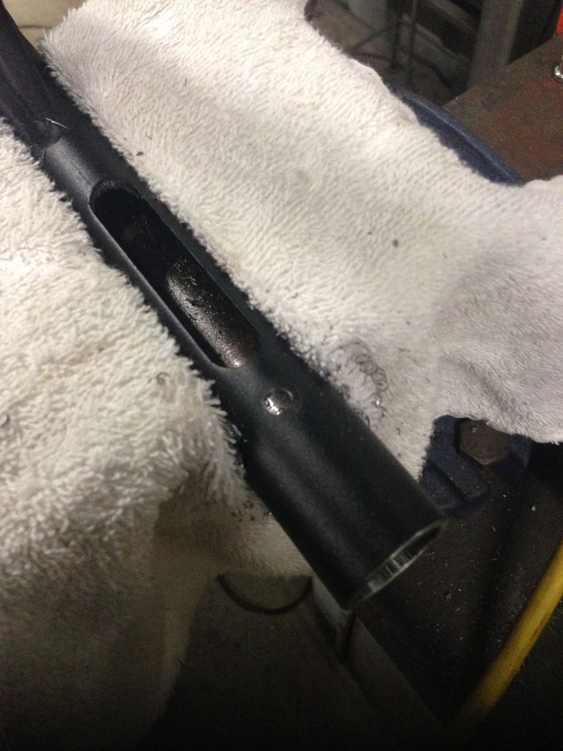

Still waiting on a couple things to be able to get back into working on setting up the rear end, so I got to work on the bars.
I had Exiles internal throttle and Grip Ace switches to install. The bars tubbing is thicker then normal so once I shortened the throttle side bar, I realised the internal throttle wouldn't slide in, so I then machine 2" inches of the inner surface to a perfect fit with the internal throttle. Drilled a hole for a grub screw that goes into the internal throttle housing and will use adhesive as a precautionary, but as it sits, it's a strong fit with no play.
The grip ace buttons proved a pain in the bum to cut into the grips, lucky I bought a second set as I *#@** the first one up good and proper. Drilled a hole for the one wire to go in and she's all almost done. I've just got till the top end is back I can work out the length for the throttle cable to cut it to and run it through the bars. All in all it'll be a clean setup.
I wanted a minimal look up front, no gauges, no obvious switches or controls or lights. Unfortunately due to the narrow overall width of the bars, running the brake line internal is pointless, it would only enter on the vertical tubbing of the bars, and the short height of the bars would mean it'd be a waste of time in my opinion. I can make the brake cable near and relatively hidden with the springer so there won't be cables flailing in the wind
