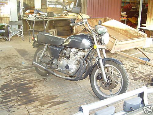

Hey all,
Whilst i haven't picked up the 850 yet, I have got a photo of what she looks like now and what I'd like to see her looking like the only differences being the colour (flat black) and high bars (16").
It looks pretty simple but I know that this is never the case, so please I'd love to hear some feedback on the idea.
I was thinking of using struts but I was taking to Andrew he was talking about shortening the rear shocks by re-adjusting the shock body and cutting the springs down, would love to hear others stories on how this is done.
Any way only 1 week and 2 days 'til she arrives......then the fun begins
Pete

something like taht would look really nice as a cafe racer!!!
Post by Cromag » Thu Jul 10, 2008 8:31 am
the second pic is probably a gs750 (chain drive) the second...could be either from the pic, (so lets assume is the shafty).
i reckon keep the shocks too, i used toride a struted 750 suzuki in me youf, and it was Ace, wish i had pics..it had 16 inch apes, solo seat (chopped up stock seat) short struts and went like a scalded cat....in the end the carbys carked it and m,ade it difficult to start. So while fixing those i reshocked it put a gsx1100 front end on it (lots of work) flat bars, solo seat and ducktail..was pretty good bike. Easy to do engine work on (rocker cover come off with engine in situ).
me id curve the seat rails so they made a comfy bucket, and place the top mount of the shocks as high as i could on the new rails, maybe shorten shocks....fat bobin the tanks loks ace as does spoke wheels 16's both ends.....
Lookin frwd to seein it evolve. good luck.
