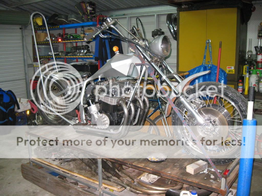

the bike is coming along well all cables fitted and opernational
carbys are on but there a ratty set , just got the bodies back from the cary shop and there all gold and clean and on the bench going bact together , battery will be in on wensday i have a harness stripped out and going to use all the genuine honda coloured wires so i dont have a night mare later a little anal i know but thats just me
chain fitted so friggen close i can almost see me misses in the mirror !

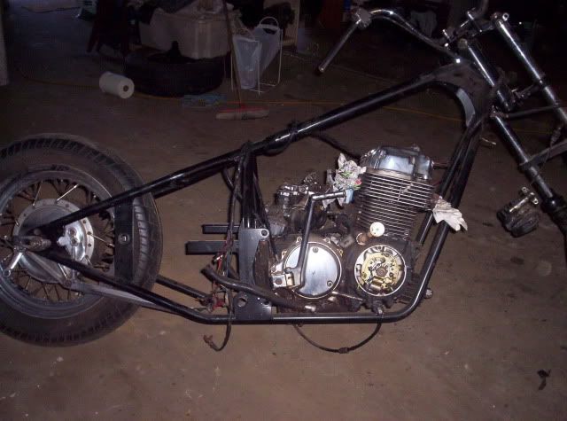

Had to go back to the begininng of this thread to suss out what your frame is..Amen ? what gives it away as an amen, i am just wondering because i picked up a roller today and it looks a dead ringer for your frame, same rake etc...there is one difference and that is the axel plates have a round/keyhole type of thing cut into them...any clue as to if these are Amen stock? Cheers mate.
pic of the frame (not trying to jack the thread, just hopin you got some knowledge on this)
chewi
Posts: 72
Joined: Sat Feb 18, 2006 1:45 am
Location: perth
Post by chewi » Sun Nov 01, 2009 3:17 pm
hey cromag,i like that frame,but im pretty sure its not an amen frame
Post by Cromag » Mon Nov 02, 2009 9:00 am
Thanks Chewi, I was just about to say that.
Had a bit of a search around the inerwebthingy and came up with the advertisment pic for AEE over on the hondachoppers.com
This here is the link
http://www.hondachopper.com/gallery_mis ... e_ads.html
notice the same gussetting around the steering head, the bottom frame rails also have that long kicked up section too (I suspect this enabled you to do a straight swap from stock to chop using the standard 18"wheel).
Anyway as both Pigbody23t's frame and i seem to share the same geometry (10' out and 6 stretch") and gussetting (Ooohhh i like your gussetting edna is it AEE?)i think both frames are AEE.
a quick look revealed that Amen have a distinctive stroker bar under
Apparently these frames (AEE) were also sold under the C&G monika too......

Got a March 1977 Custom Bike Magazine here with an Advert for C & G Mfg. Co, which has a pic of their "Custom Rigid Frame". 1" Rake & 5" Overstock. $169.95 US !!
Looks exactly the same as what you have. Got those distinctive Engine Plates & same gussetting.
My Scanner is out of wack, but if I can get it up, I'll post it. (Better rephrase that!??) :D
So I'd say you are on the mark!
