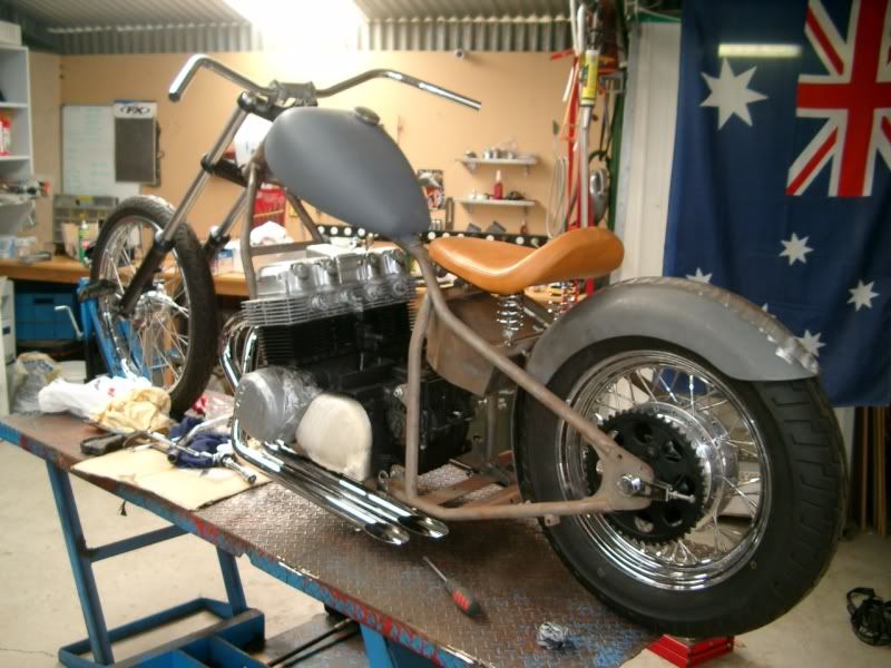

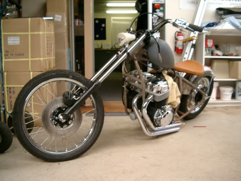

Post by Ol Fart » Sat May 16, 2009 11:28 am
Here's a bit of an update. Ive had the frame raked a bit, to let the motor sit level. also had a fender made and bought aseat.
The motors being put back together and should be back in a week or two.
Post by Cromag » Sat May 16, 2009 1:40 pm
Certainly has a nice stance, and you might have written it previously in the post, but i missed it...but thats gonna need a longer front end...once you hit the anchors on that the whole rig will dip and change the trail (maybe for the better/maybe not) but those rails will be dragging dirt i reckon.......that being said..i reckon it looks Ace!
What rake is it...Woah.. or WOAH!

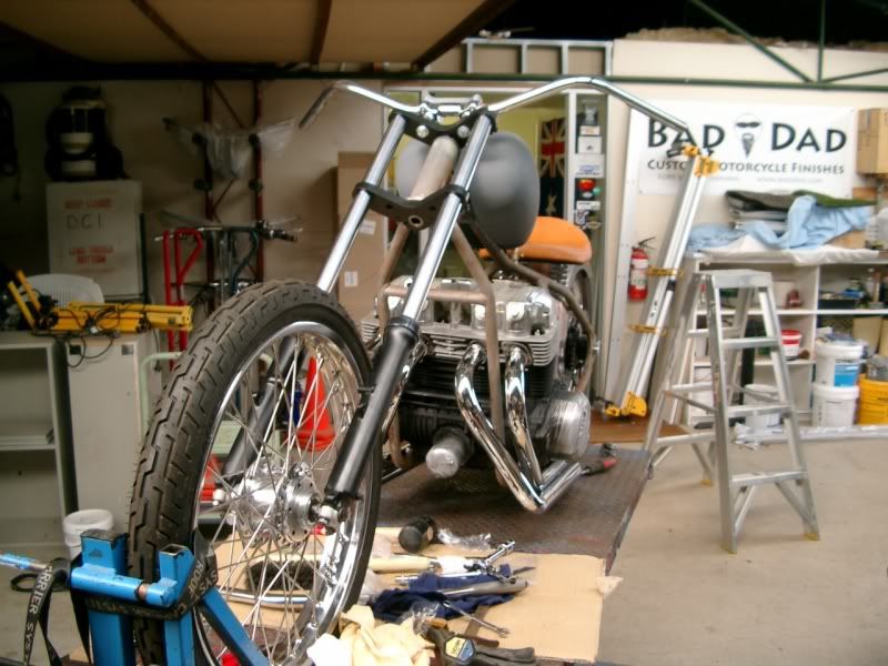

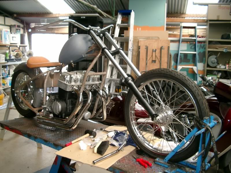

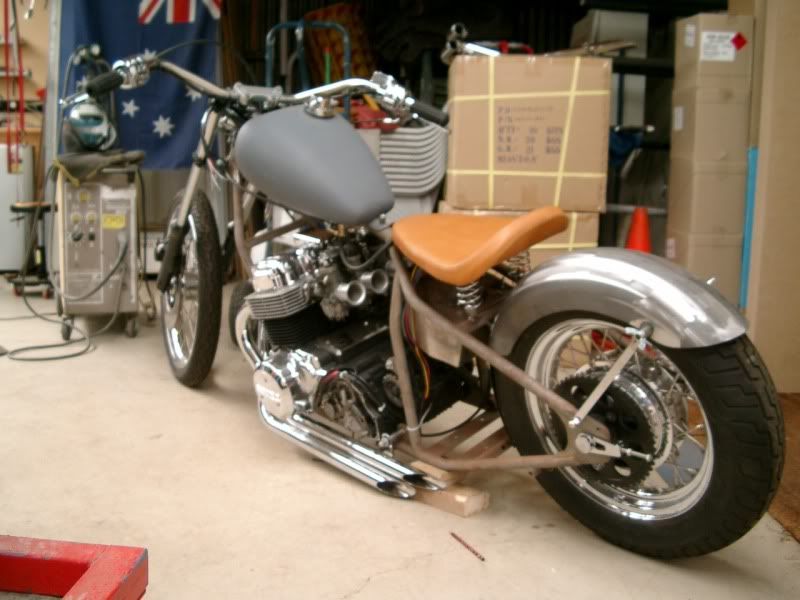

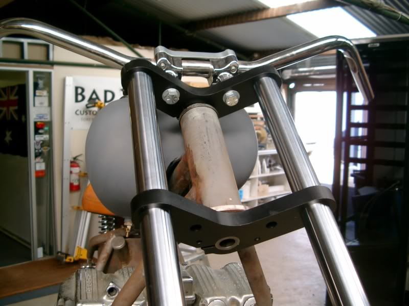

Post by Ol Fart » Mon Jul 27, 2009 2:53 pm
Here's some from today, got the engine in for a fit, put the pipes on and have the seat mount sorted out witht the rear fender mount.
Various bits painted, new triple trees. surprisingly, no bark lost today with engine install.
What??? no lean angle?
It's not made for leaning, its made for, other things...

Post by Ol Fart » Mon Jul 27, 2009 9:21 pm
It was registered previously, so the reg office only wants a certificate of roadworthiness.
Either that or I buy a donor bike.
Either way, its dodgy, but it wont be the first time Ive ridden an illegal scoot
midnight7503
Posts: 927
Joined: Mon Jun 25, 2007 10:11 pm
Post by midnight7503 » Mon Jul 27, 2009 9:45 pm

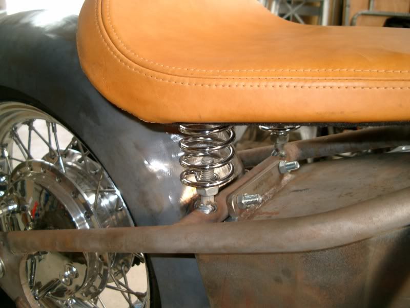

wheres the rear guard from? I like the look of it
“There is no heaven, there is no hell, except here on Earth.”

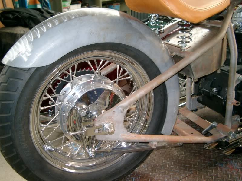

Post by Ol Fart » Mon Jul 27, 2009 10:02 pm
It was originally a new 9 incher. I had a hot rodder, cut a 60 mm strip out of the middle and he brazed or bronzed it back together. Its pretty snug. It also has a ridge that you cant see in the pic
I have the original Sonic fender strut that Im gunna cut up to make the prop.
After seeing the pics of Spokes bike, Im gunna do the mount on the fender, like the bottom mount of his sissy bar. Very trick

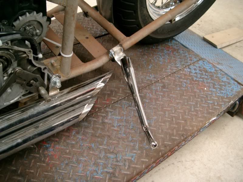

Post by Ol Fart » Tue Oct 06, 2009 10:53 am
I took it off the work bench to set up the kick stand and get a bit more welding done.

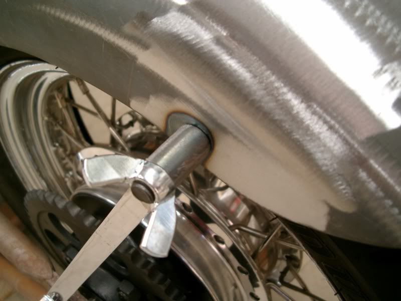

OK, always had a soft spot for wing nuts

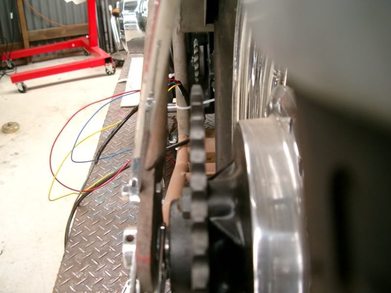

I love this shot, everything lines up real nice, see the 10 mm offset sprocket down there on the donk ?
Im waiting on a set of forwards from TC Bros in the USA.
I decided not to use the billet HD aftermarket ones. I was also contemplating using a hydraulic disc brake rear end but this bike has cost way too much so far. Time to reel in the costs, get the fab done, pull it apart, paint it and get it on the road.
