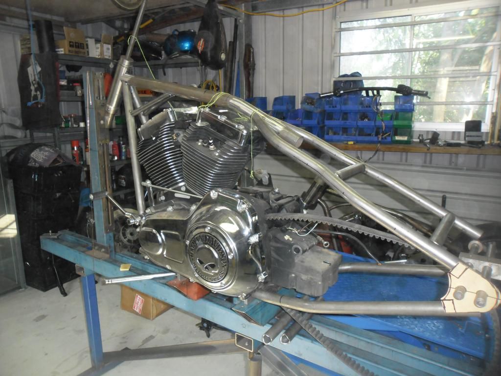

heres the next chop this one is gone to be sort ov a race/bobber /chopper.... or something like that
so far weve got a 08 103ci TC
thundermax ecu
buell forks
chunky tripple clamps
200 16 rear -130 16 front spoked wheels
thats about it atm just chassing a few parts
still quite a bit to do on the frame but hopefully wont be to much longer :twisted: :twisted: :twisted:

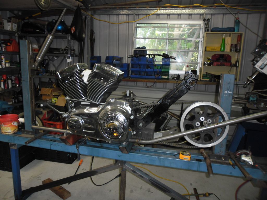

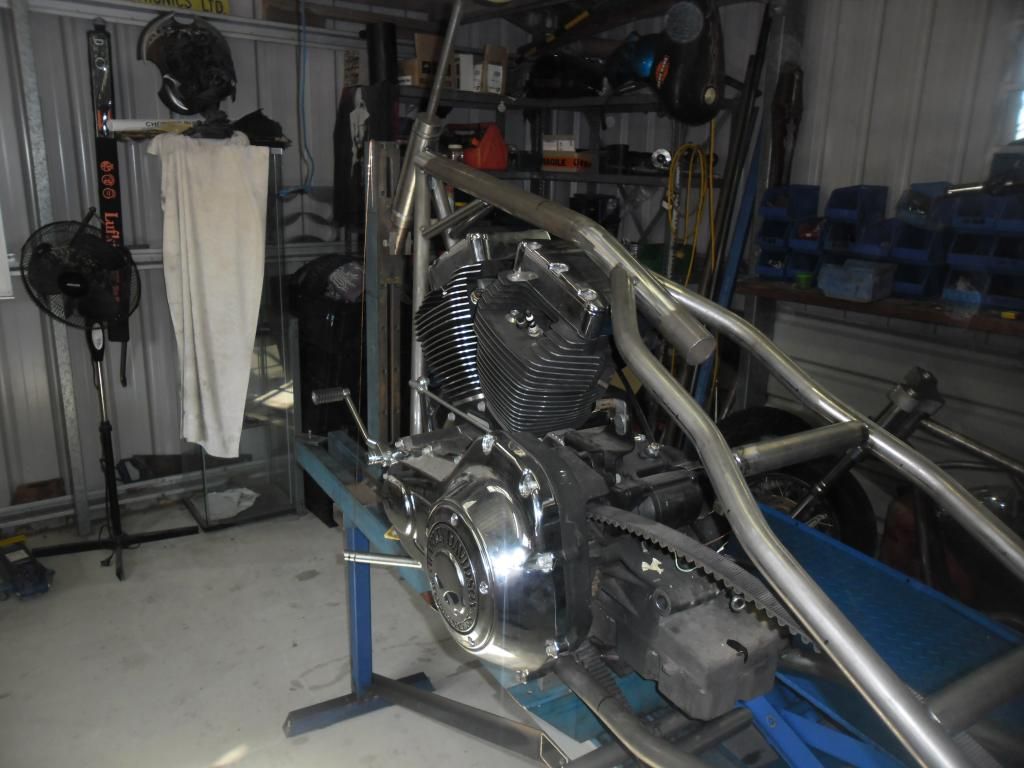

o and heres a quick dummy up

Fat!..i like the chunky look....

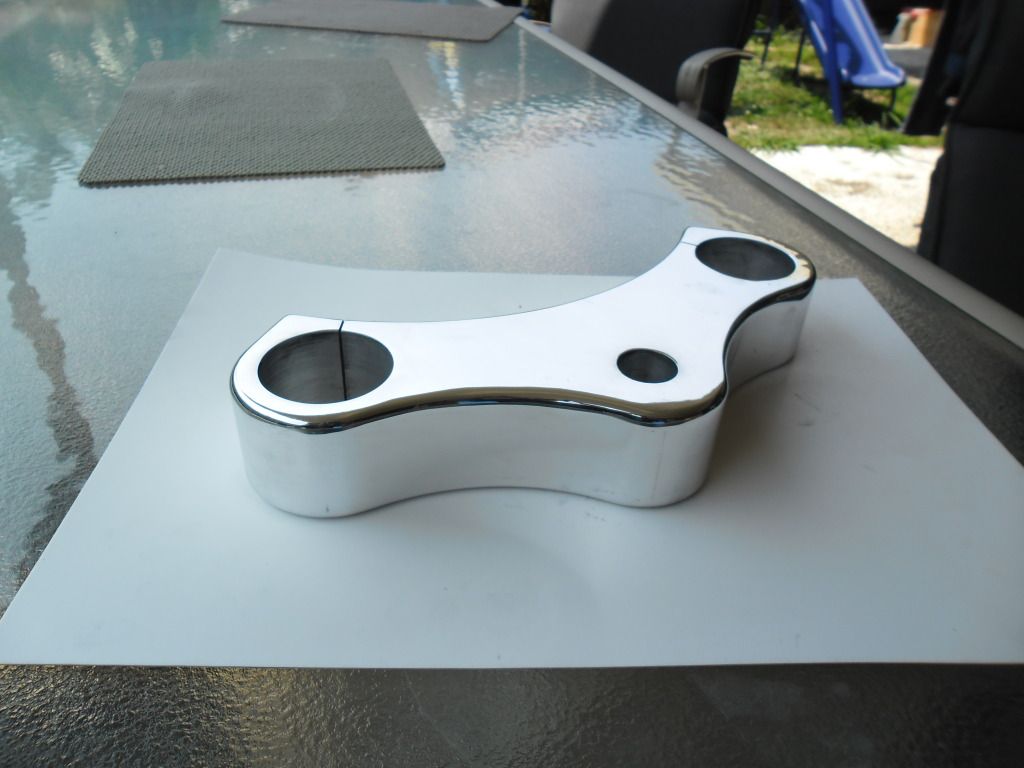

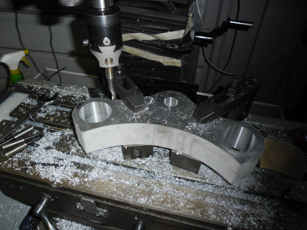

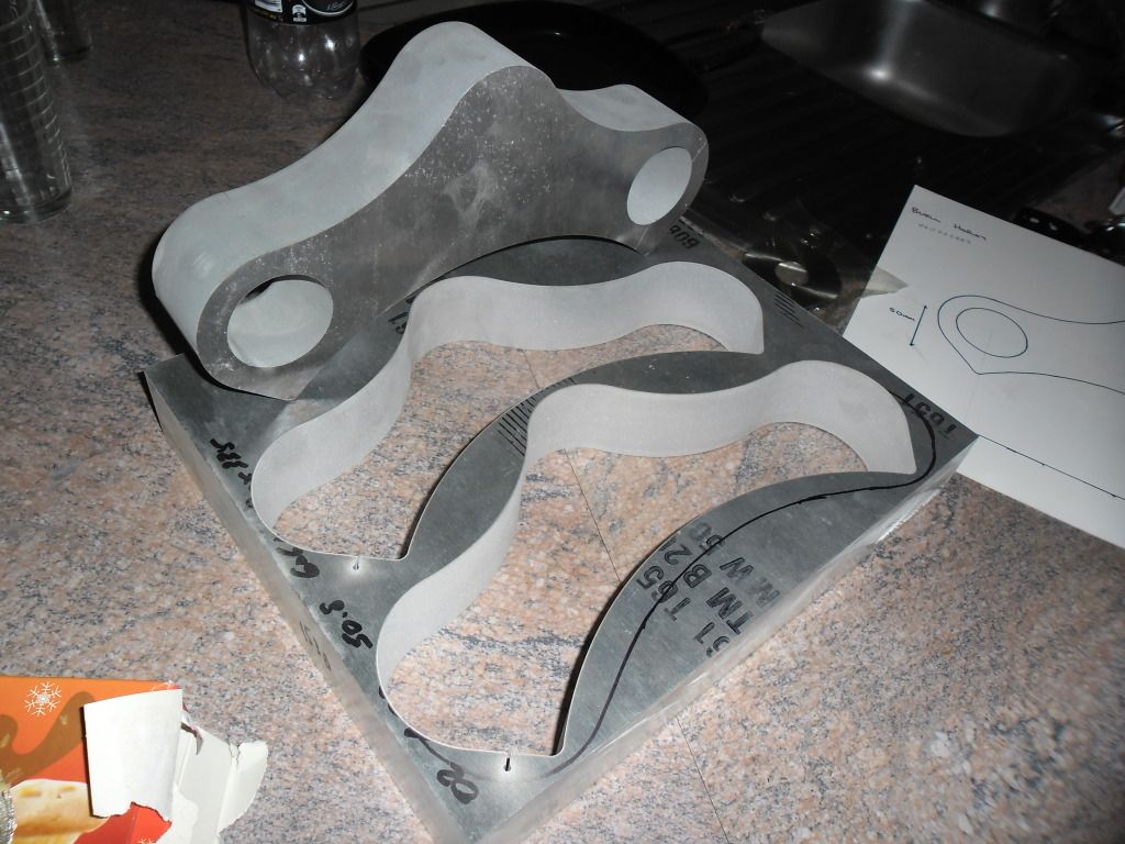

Beautiful work, water jet must make life easier ! amazing to plunge cut something that thick.

KBG wrote:Beautiful work, water jet must make life easier ! amazing to plunge cut something that thick.
thanks
makes life easier but its not exactly cheap
thats 2in thick and they reckon they can do 4in
would have taken about 10hours with a jig saw :roll:

I saw one cut some 50 mm ss very slow! keep the pics coming impressive stuff..

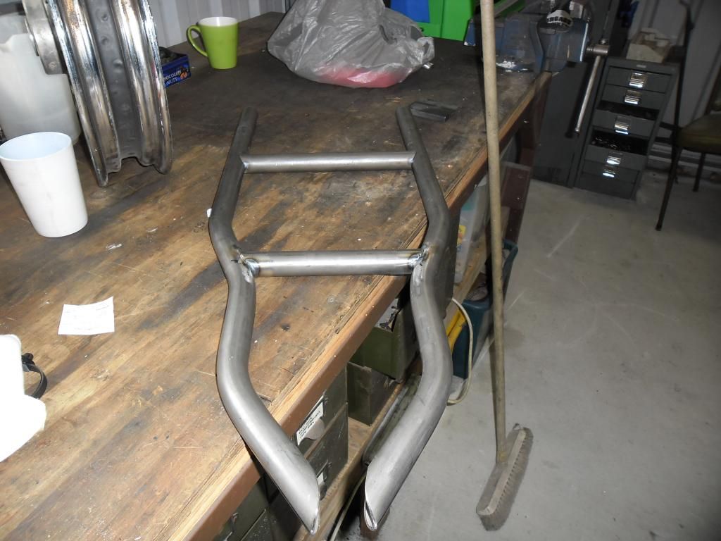

i made some tube ends this morning before work and ill probley machine a slot in the end were it meets the axle plate
