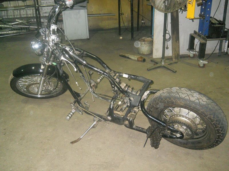

6 days later i made a start on it.
The motor went to live on the bench for a while.
The rolling frame went off to work and got chopped.

made up a bar to make it ridgid while i have it as a rolling frame to find the stance that i want.
New rear fender turned up and was about an inch wider than i wanted it so i sectioned it down the middle and welded it back together when i was satisfied with the width.
rear fender is mounted up and ready to go.
i also got my tig on and made up a bracket for the seat springs and the mount for my tail light and licence plate.
