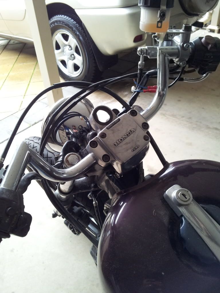

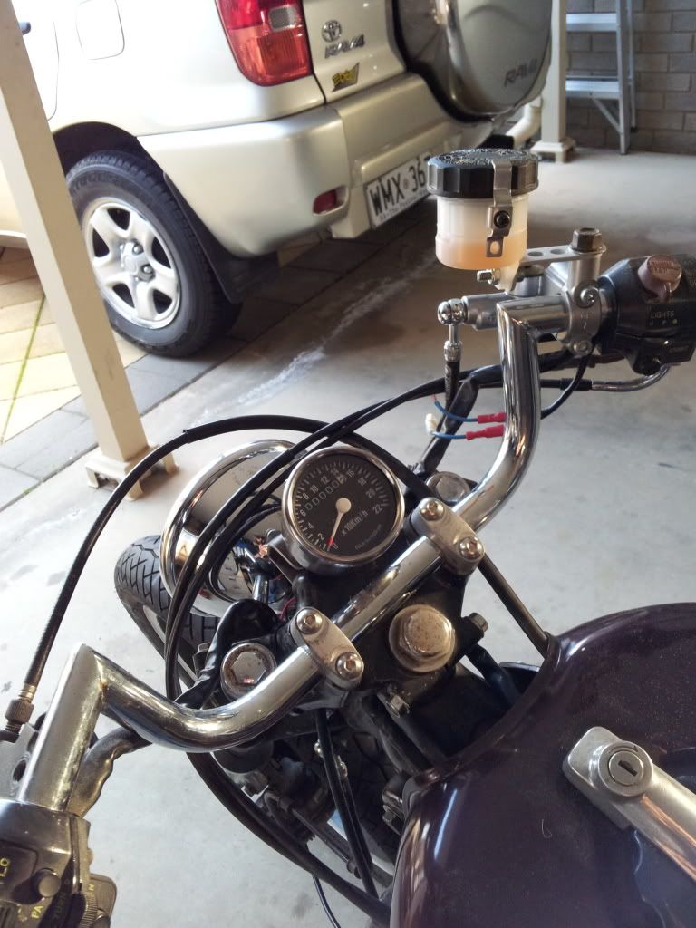

Slight change over the weekend. Much better I reckon.
Before:
After:
