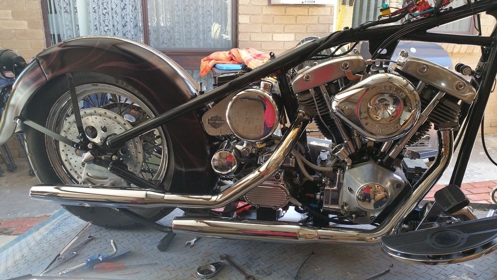

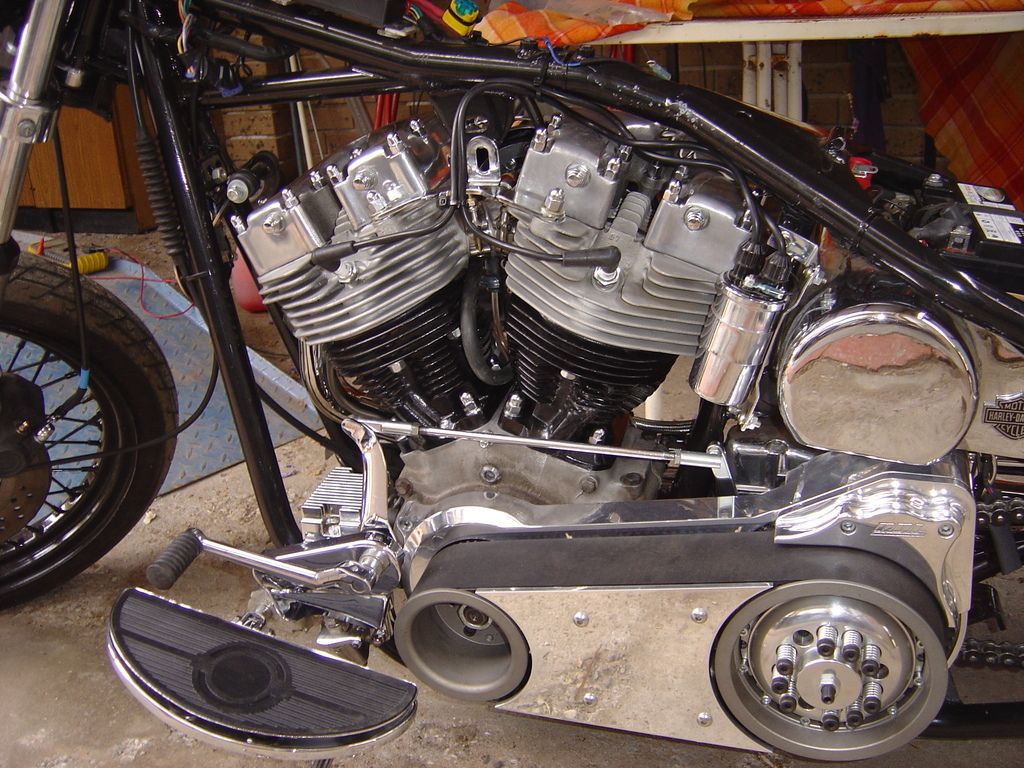

Then today tidied up the wires under the spedo assembly. fitted the chain guard rear fender & front fender. and the seat. touched up the chips/scratches in the frame also painted the exhaust bracket. Image. Yes the wires are tidy even if they look not to be so in the pic.Image. Also filled & bled the front brake.Image. Thaught the metal flake would show up in the pics but alas not to be.

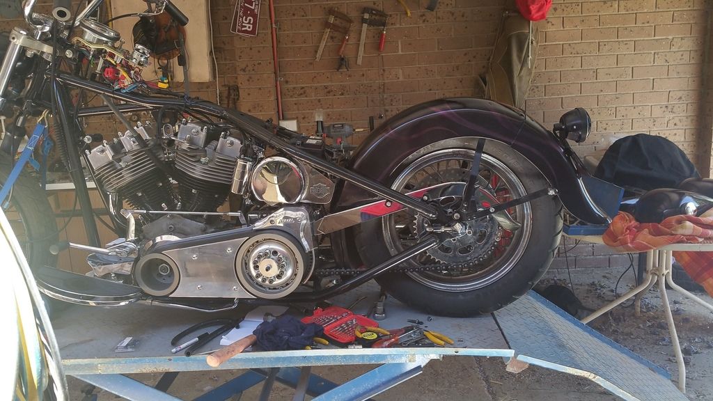

The reason I haven't fitted the tanks is the top mount is too short waiting for a longer one to arrive so it is easier to fit without them on.Image. Image Image Image. Then seeing as how it was already out the front and it was a nice sunny day and I ain't ridden for over 12months, I decided a test drive was in order. So the fuel line holds a little fuel the carby bowl a little more, Hmm dribble some fuel in till it's full. hit the button kick it into first off down the corner and back to the other corner, then home nice, brakes work gears work clutch works. Engine runs smooth and sounds nice too.Now if only Pete can find that longer mount he's got I will be off!!!!

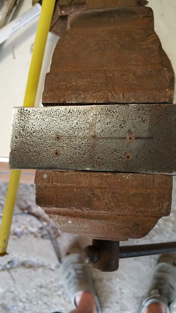

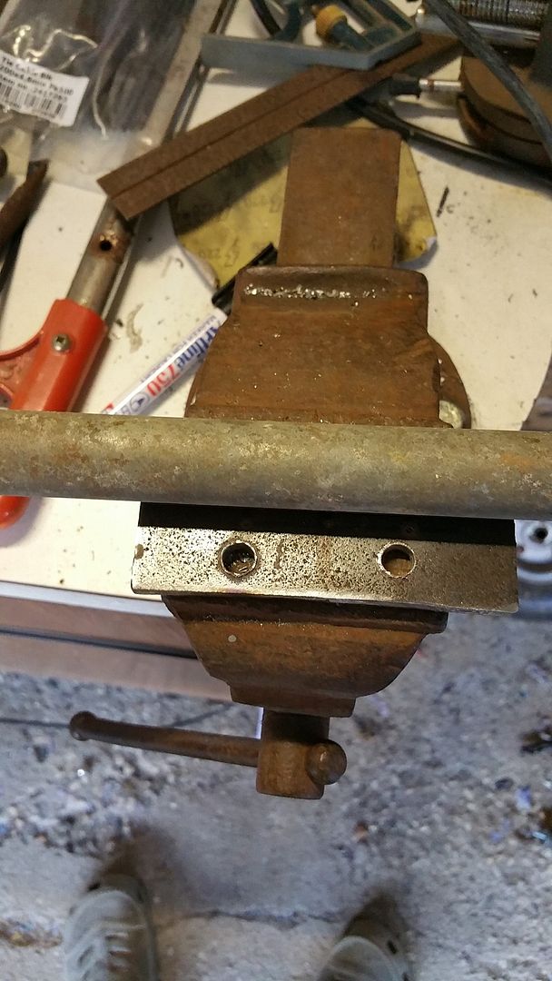

The pillion seat arrived today. But I still have a problem with the pillion pegs, the clip ons I ordered don't exist or more precisely the company that made them doesn't. So I decided to make my own mustache bar. First cut the plate and center punch the center and bolt hole positions then offset the holesImageThen drill the bolt holes Image position the tube test for clearance Now mark center of the tube and punch for reference measure the width of the base and punch too. this is so you dont wipe off the marks.Image

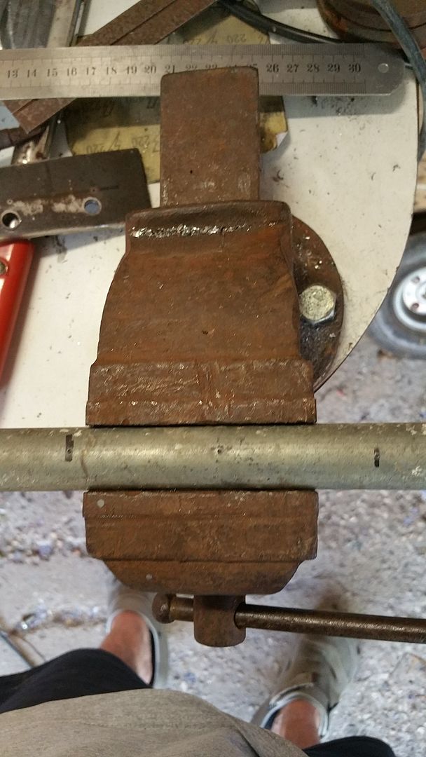

Next cut the first angle in the tube followed by the second Image and bend to the correct angle 45 degrees in my case.Image test on flat surface for alignement bend back to match. Test fit to bike Image

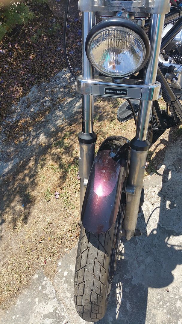

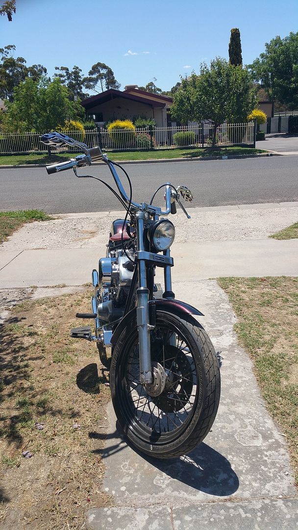

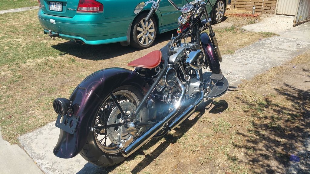

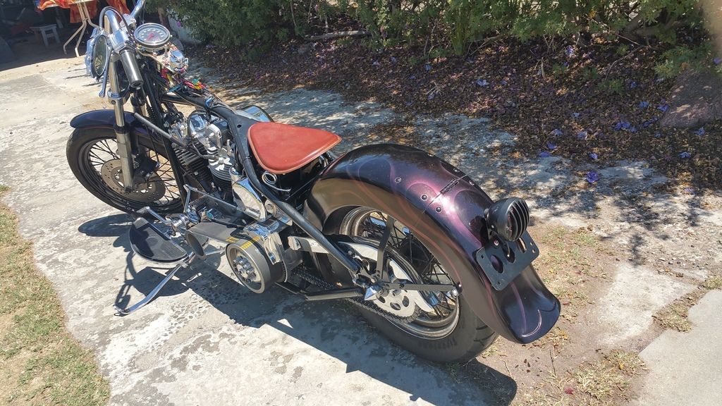

finished her today took her out the front sponged her down & her are the pics.ImageImageImage
