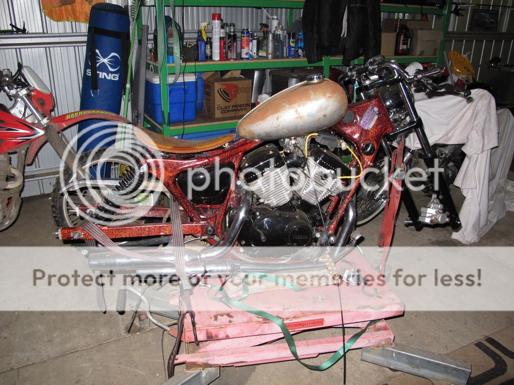

Thought I'd post up a bike I have started working on, brought it off my mate for $800 bucks in parts sitting in his shed, so I've started putting it back together, got a few different idea's like a rat-bike or the old school chopper look.
anyway now that I have just returned from holidays thought I would start throwing some money at it and get this bike on the road.

Wow...psychedelic paint job on the frame. Looks like you got exhaust, frame and tank sorted. Interesting.
Keep us posted.

Yes cool paint job... did you do it? Tank looks good on it too.

My mate did the paint work, exhaust will most likely be chopped or modified in some-way ...as most of theses 250's sound terrible, finishing of the rear guard this weekend, and should have the rim's back from the powder-coat guy by Tuesday next week ....main issues are wiring , as I have no clue what I am doing, but I have spoken to bloke who is going to help me out ....... (if only I was still in Adelaide I would be around at the chopper shed :D )
Anyway will post more photo's as I continue my work.
