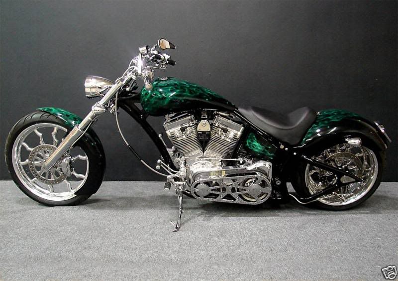

Ok here is the kit - it but it will give you an idea of the look I am going for:
http://cgi.ebay.com.au/SMW-Inc-Australi ... 27b8493c41
I thought a soft tail with wide rear conversion could achieve a similar look?
Do you guys have any other ideas for suitable donors.
id l'ke to keep the low sleek look and avoid the high top tubes.
Totally understand your point about buying a rego'd bike and going from there. Ive taken that path when building cars many times but would be great to for once have a totally complied and legal vehicle. esp if i ever go to resell.

A 1990 onwards heritage,softail or deuce with 5 degree raked neck cups and a wide tyre swingarm conversion will get a similar look to that which you are looking for but you you can buy one for about 13 to 16 grand depending on mileage and condition.

Looks like that front will breeze through the 550 rule, nice lookin bike
