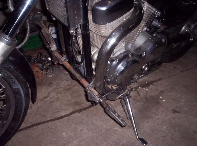

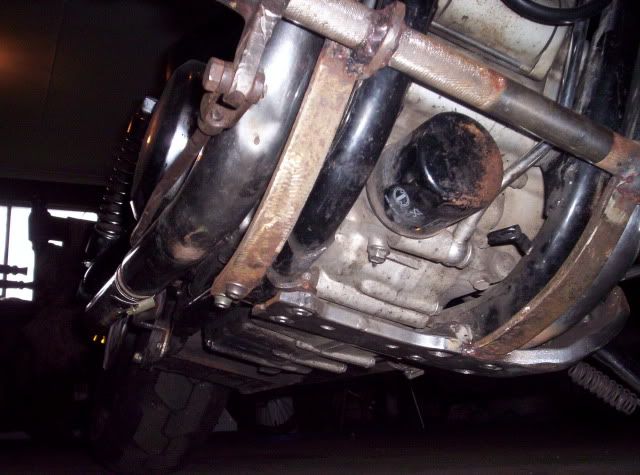

heres the begining of a set of frwds i made...not yet cleaned up, but i used the original footpeg mount, a weight bar, and some old truck pedals and chopper pegs., had to brace em back to the original footpeg mount, but i could stand on the suckers with a full 150kgs...and they were solid as and smooth operating.
what ever you use, run a brace over to the other side peg, itll help with stability

Thanx Cromag would it be easier drilling the frame putting weld tubes in be nicer cleaner look
