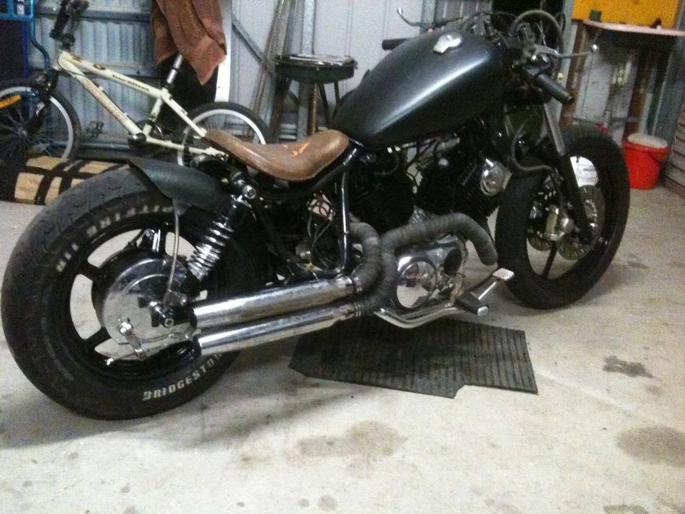

I suppose I better do a bit of an update..
Painted the heads black.
Slipped these tapered turbo mufflers on. Ran like crap, (unequal pipe lengths). Don't really like the look of them either. Whilst idling it had a bit of a "Poop" noise every 3 secs.
(bars are not mounted, waiting for risers to arrive in this pic)
So in the bin those mufflers go. Going to make my own that look "straight through" but with some baffle inserts and a neat little hidden X pipe to balance the head pressures. To rid that nasty "Poop" sound during idle. Yay.

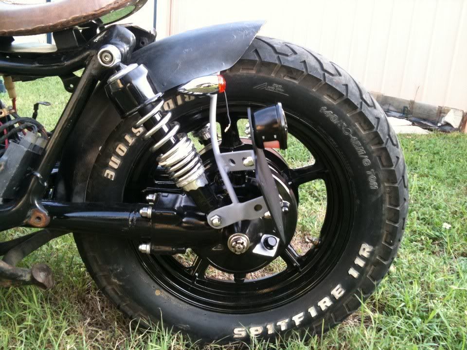

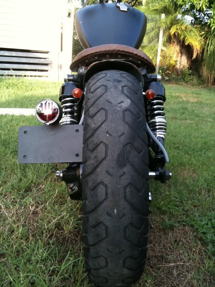

Mounted the rear plate bracket. And some bullet indicators.
Now that the rear fender is all finished with brackets etc. I'll start to prep it and the tank ready for paint.

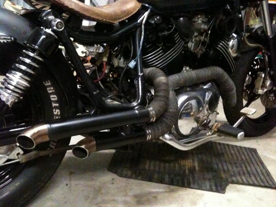

New pipes. Yeah I know that didn't last long. Hahaha.
Both have baffles welded in each end to quieten it down a tad. I like stuff with a note.. But not "Hey!! Look at me!! Loud, if you know what I mean.
Has a cross over pipe to help equalize head pressures and stainless dump tips.
It was getting late and I didn't get to fire the big girl up. But i'd say it will be just a fraction louder than the original setup photo. Technically its a 2 into 1 system. Just with the looks of a dual system I suppose. From what I've read it helps performance and economy since the head back pressures equalize. I hope! Haha
Of course it will all get heat wrapped in black fibre glass wrapping to match the headers with just the stainless dump tips showing.
The stainless dumps are left overs from the original exhaust. I always try to reuse as much as I can.
