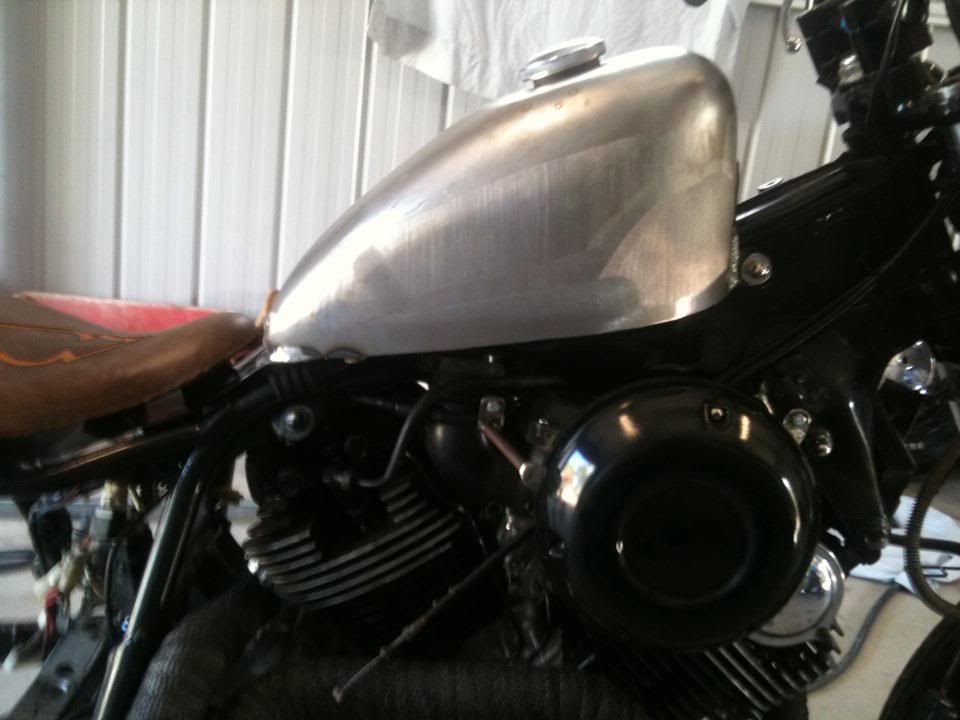

Getting there slowly..
New bars.
New tank.
Fabbed up battery box.
A few headaches.
New bars.
New tank.
A few headaches.

Wow, good old Sporty tank saves the day again. Like.

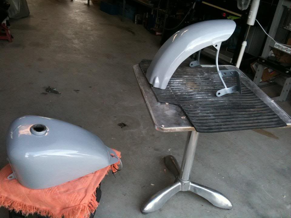

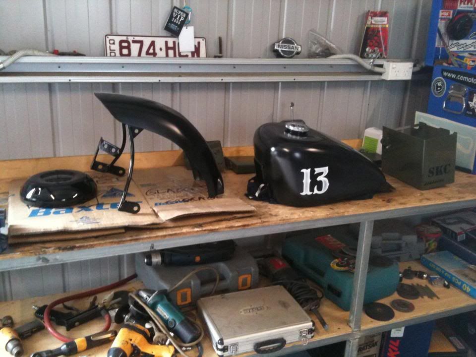

Tank is done, came up well. It holds liquid without leaks pressure tested at 10-15psi. So I'm happy with that. I've also run a tank sealer through it to stop rust and further durability for years to come.
It utilizes the stock mounts. Making it user friendly. So making the swap to the larger stock tank is easy.
In primer! This high build 2k primer smelt like coconut. Very nice compared to usual.
NEXT! Everything sanded down and the Painting out of the way. Broke out with the airbrush that I'm lucky to use once every 4 years.
I mixed up my own brew of polyurethane satin black and gloss black. This stuff is industrial grade gear. So its super heavy duty stuff, compared to normal 2k satin/matt paints are very "watered" down with matting agents making them very weak. I've painted the whole bike with this stuff. Came up really well!
Quick bolt up to see how it looks.

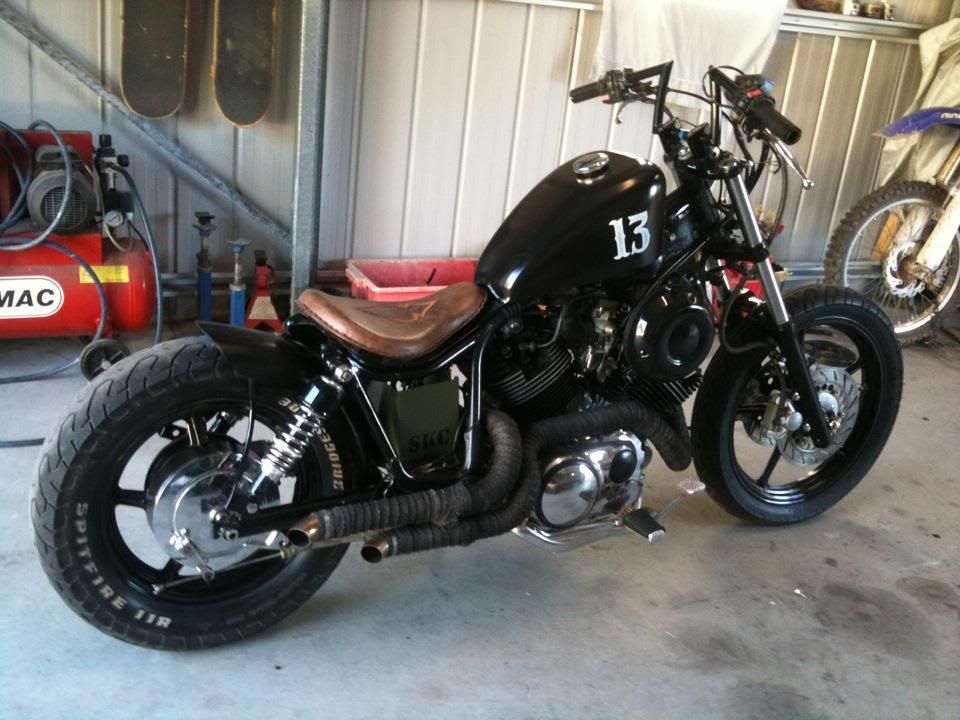

Thanks Ross.. Getting there. Finally!
Slightly better photo than the dirty old Phone camera low quality.
Spent hours wiring and getting rid of the "un-needed" crap.
All the frustrating hours paid off. Everything still worked!
All this used to be in the stock battery box/side covers etc. Now all neatly crammed under the seat between the frame rails so its easy to get to.

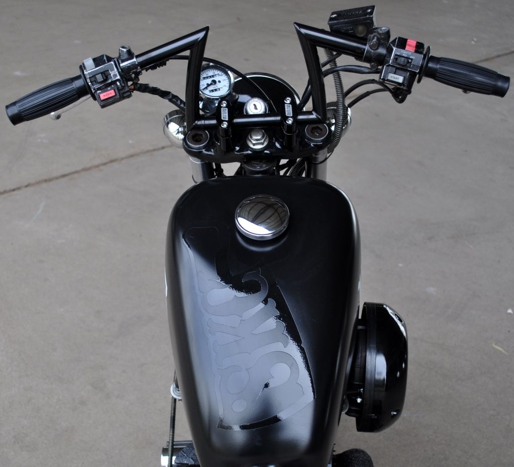

Re: XV 1100 Bobber Project : QLD
Its finished! Alive! Creeping the streets as we speak!
Pretty stoked how it turned out!
