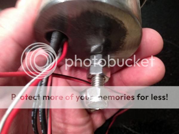

I know I'm no fabricator by any measure next to the guys on this board, but I had a couple of little ideas recently that worked out pretty nice for my pro street Roadstar.
First, I ordered a GPS speedo from Speedhut, which you can design online to your specs. Problem is that the Speedhut speedos are really made for installation in a dash, with a spin ring on the back- so I had to make a gauge cup from exhaust tubing, then had a welder friend weld it for me. I then took it to a local chromer, and put it on the bike.
Second thing is that my crankcase vent tube was ran up to my hypercharger. (Yeah, I know, you either hate HCs or love them) The HC has a groove in the bottom rear that I'm guessing is there so it will get enough air at a standstill. When I would ride all day on hot days, just a few drops of oil would come out through the groove- which wouldn't be a big deal, except they would land right on my pipes. There was a bolt connecting the hypercharger bracket to the mounting bracket between the jugs near the bottom.. so I had the same friend weld a socket cap screw to the back of the flask, and used it to replace that bolt. Then I ran my vent tube into the flask.
